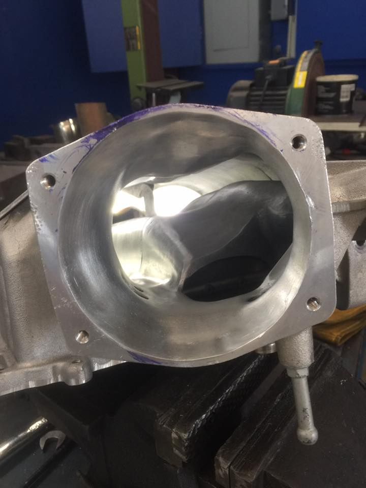

My design is consistent regardless of what is being said. No one knows my process of porting. No one knows what I do how i cut or where I go. Anyone who does porting in real life and is hands on knows that air creates a air boundary layer that's fills in imperfections . The other thing is my design takes into consideration how the air travels inside the case and how the shapes you port effect the air. My other feature that helps me gain the edge is low pressure high pressure points inside the case. Meaning if you port a low pressure area you just lost horsepower. Guess what I know those points. I know as a positive others did not do the amount of testing I did. 15 designs and 15 different areas of testing on blowers I can tell you I can swing he dyno from 24 hp gained to 42 hp gained with some minor changes in porting. I can make torque at the flick of a switch.
Recently did a test With one of my old ports vs my new port design and it picked up 1.5 lbs over the old on the same day
Here is the test from last week same day
