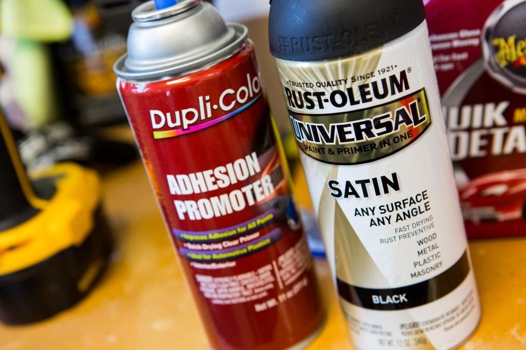

Exterior
- Chrome window trim vinyl covered with satin black
- Satin black painted grey plastic pieces and front lip
- Satin black painted rear chrome trim
- Gloss vinyl wrapped and black Plastidip front grill
- Tinted rear tail lights
- Satin black painted chrome headlights
