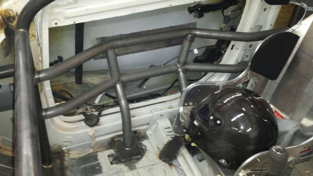

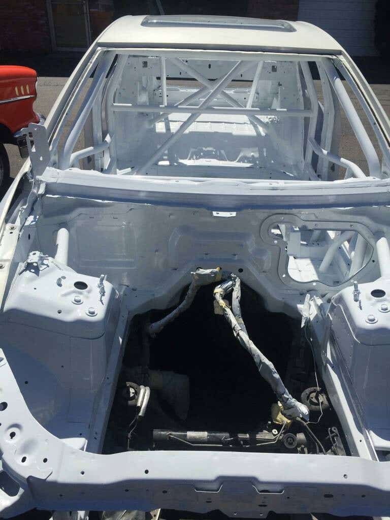

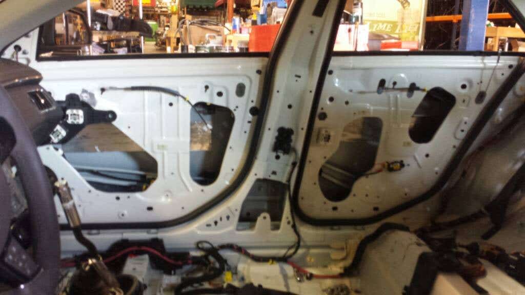

Strip the interior
Full Cage
Ditch the blower for big inch N/A action

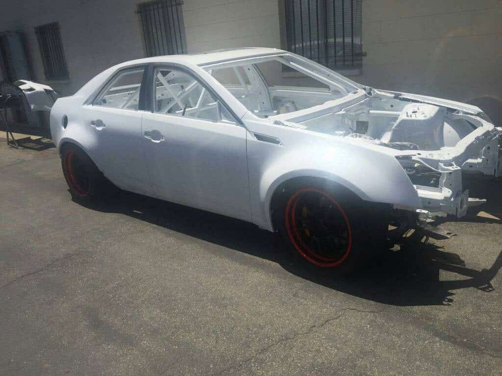

Wide body

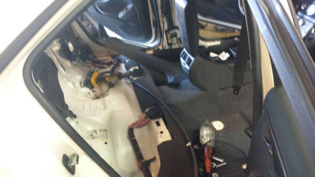

Starting to strip interior

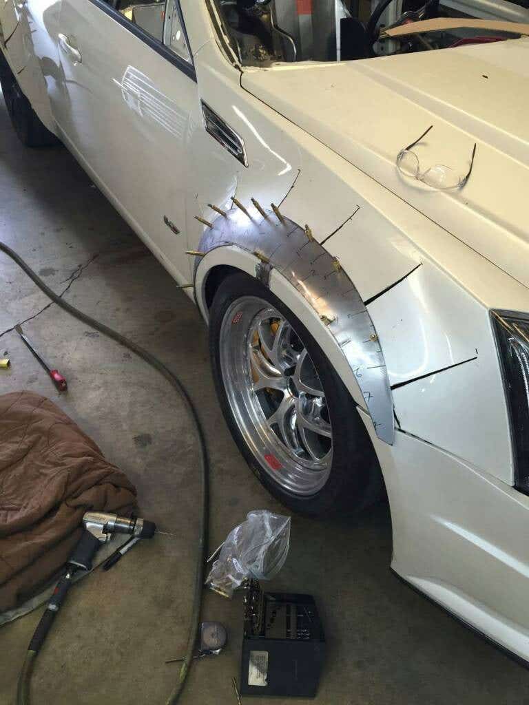

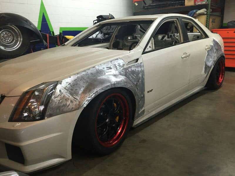

Wide body

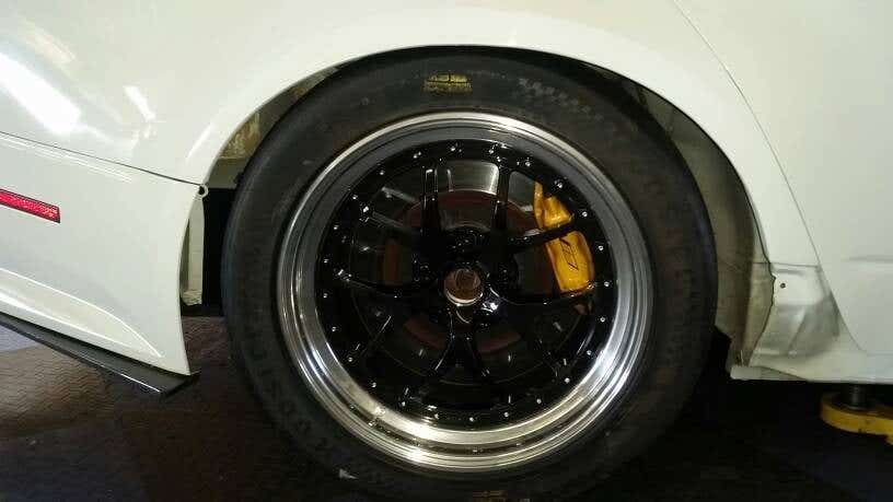

All steel Wide body for 11" fronts and 12" rears

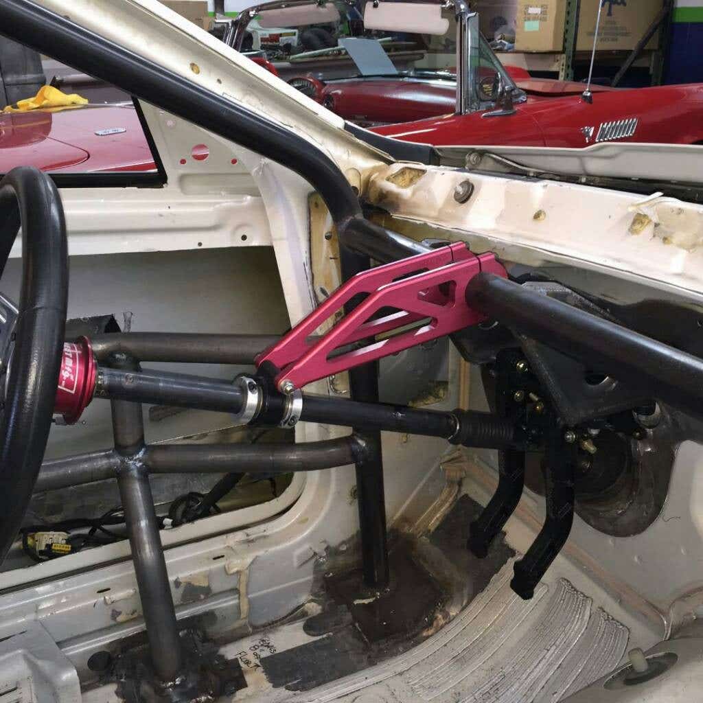

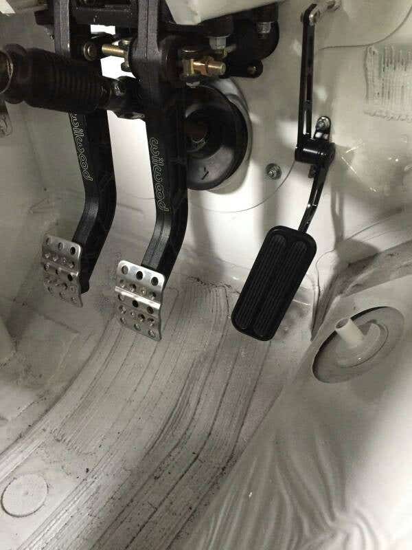

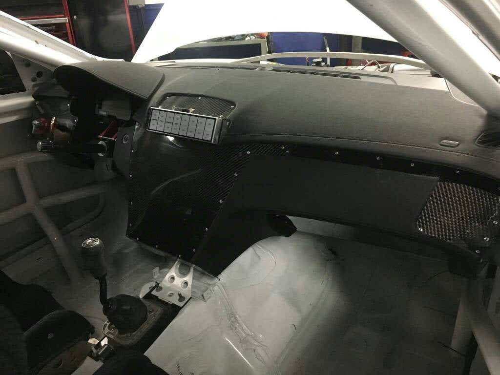

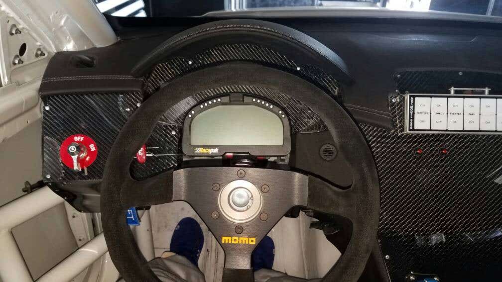

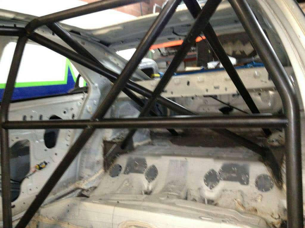

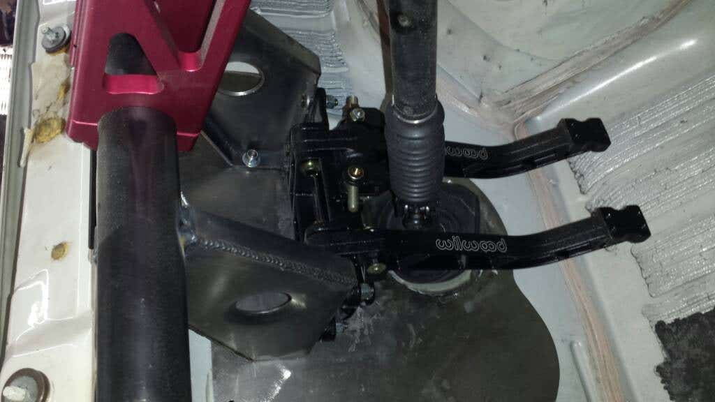

Cage / Steering / Pedals
Full SCCA/NASA roll Cage, wilwood pedal assembly, sweet steering column w/ quick release, MOMO wheel, racepak dash, lexan windows

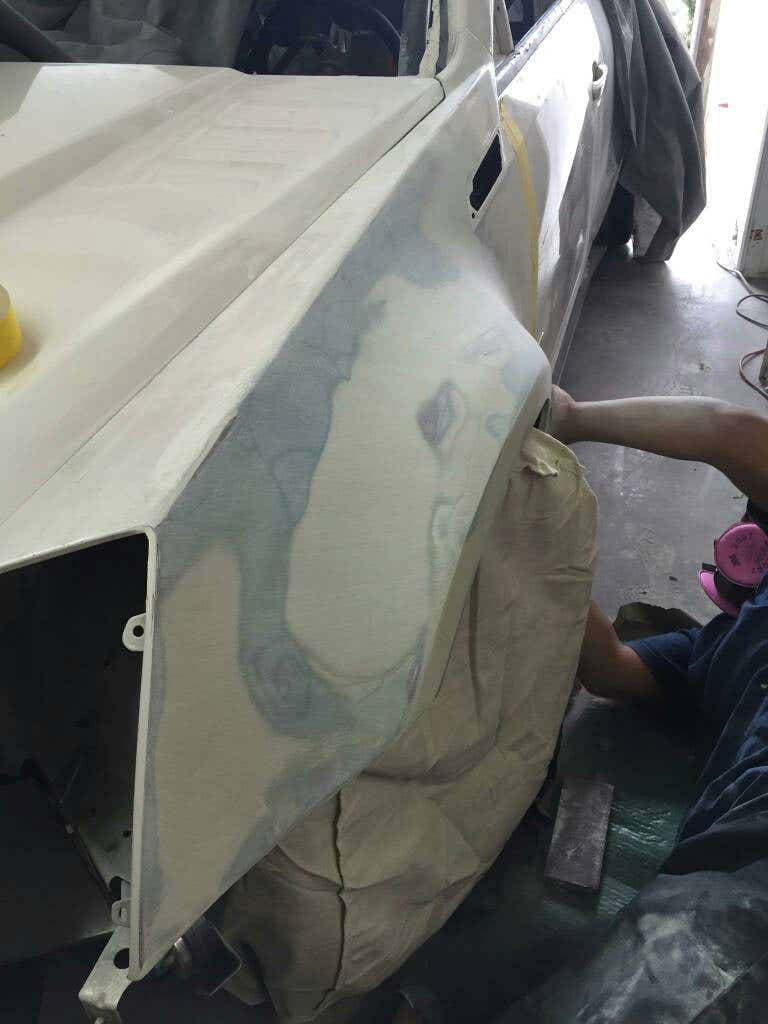

Paint
Corvette arctic white
