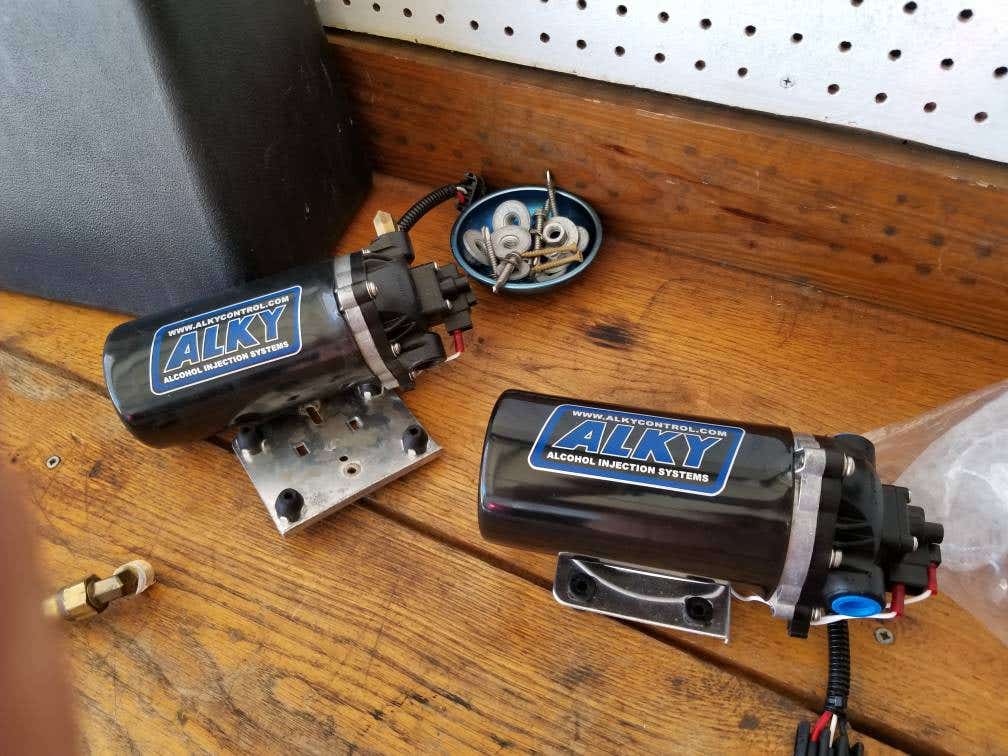

After replacing my Alky Control pump in the trunk this afternoon and testing it is working as expected in the garage. I shut the car off and went inside to wash up / change clothes for a test ride to the grocery store.
