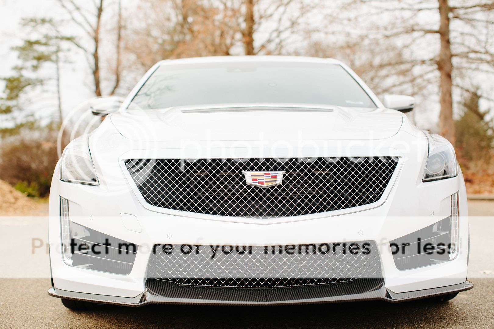

Comparing the front end of the Z06 with the V3 it is apparent that there is more surface area/ cooling openings. If you look closely you can even see the small radiators located in the openings next to the fog lamps.
