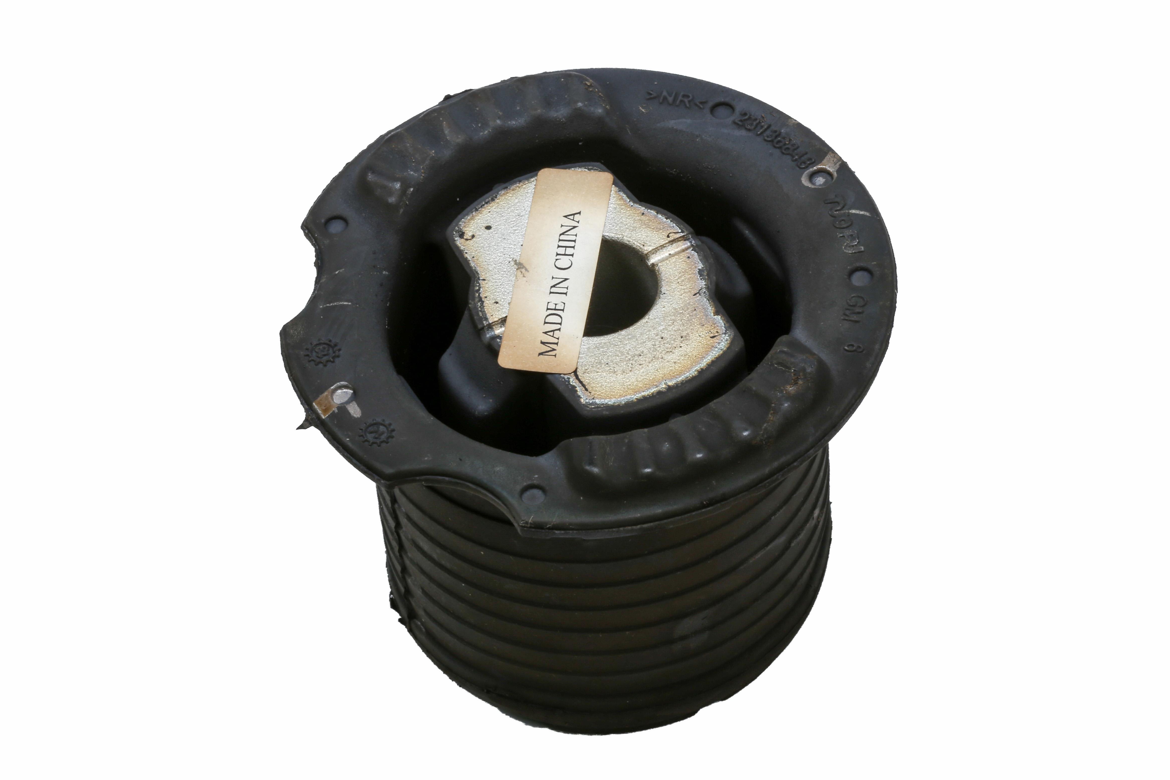

I started to remove the old bushings last night. I have read various tales of difficult removals. stripped all-threads, broken tools, cursing fits, torches.
I thought I could avoid the drama since my cradle is out of the car AND… I have 4x4s and 3/4” all-thread already and some heavy tools.
I started by drilling holes in the 4by… a pair at 40-1/4” apart and another at 37-5/8”.
Automotive tire Motor vehicle Bumper Gas Automotive exterior
next, some big ass sockets and all-thread with washers and nuts.
Motor vehicle Machine tool Automotive design Gas Engineering
I threw a strap around the 4by and added two pieces of 4by blocks… cinched it up and then started cinching up the nuts. Looking forward to this being a piece o’ cake.
It was not…. quite.
As I bound down of this (evenly) I was shocked by the resistance. I had the 4by bowed significantly and it was creaking and groaning.
Machine tool Engineering Gas Auto part Motor vehicle
Automotive tire Bumper Motor vehicle Automotive exterior Machine tool
I did NOT want to break the 4by (and it got damned close) so I finally resorted to adding heat.
Only after this did they give up. I now understand the stories I had read, most of them were doing this in the car, on stands.
Tonight I’ll see about the rear pair.

Of the two sockets I was using, I found that the one that measured 2-7/8 overall was right for the job; the other socket measured 3-1/4” OD and proved too large. It IS small enough to go through the hole without the bushing in there, but it pinches the rubber against the bore when the bushing is there.

Had a late start to take a shot at the rear bushings on the cradle. Similar setup with the 4by, cranked down on them and pretty much nothing happened.
I’m ready to put the little torch on them but the silly thing is out of gas.
I’ll pick up another bottle tomorrow and try again.

I just used a Diablo Sawzall blade to cut out the center bushing and notch the steel outer sleeve. Then large flat head and hammer to peel it in along the notch and remove.
