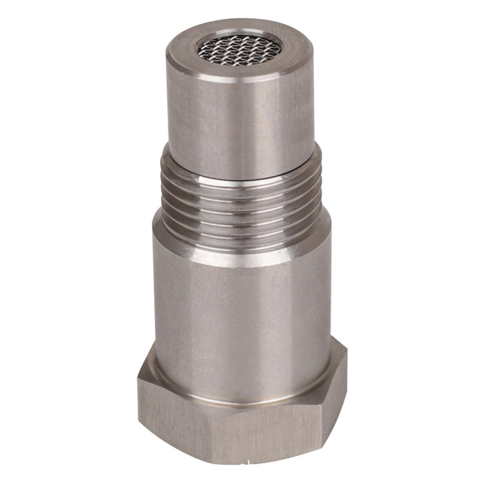

But since you state that you have no installed test pipes or high flow pipes you would either have to disable the codes with a tuner or buy cat foulers, which are basically tiny cats you put between the sensor and the exhaust stream.

You need one of these and a 90 degree one for the other side. it will get the light off long enough to get it smog checked. You will end up getting converters so your call.
So i put in SDP catted test pipes, new o2 sensors in the rear and defoulers. Still have a 0430 and 0420 code. Next suggestion??
Then I guess the defoulers are just not efficient enough even with the cattet pipes. I have never used defoulers so I really can't give you any adivice on what works or what doesn't. I just used HPtuners to disable the codes. If you plan to do any modding down the line it might be a good investment anyways to get the HPtuner scanner and software.
