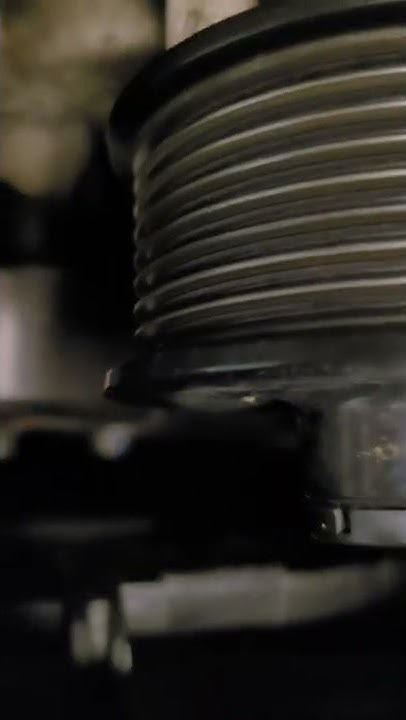

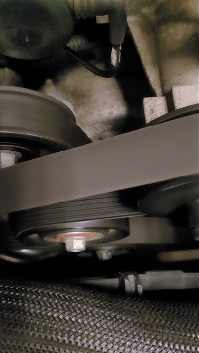

Discussion Starter · #12 ·
Update: Took off SC belt and turned it on, the noise is alot quieter. I will post a video in which it is a very faint squeak.
With SC belt off
After putting SC back on and reving to 3/4k rpm
This is the noise with only the A/C belt on. My friend who is good with cars says the noise comes the harmonic balancer.
4,006 Posts
I hope your friend is right. Too me, it sounds lifterish.
72 Posts
The noise changing dramatically in intensity with the SC belt off indicates it is not a lifter. That would make noise with no belts on. The harmonic balancer might be right and the evidence supports it. The SC belt is the frontmost belt so if the rubber dampener is rotted out it would put more pressure on it. You want to get that fixed because if it is out of whack it will put your crank off balance
Reactions: Blades1_99
10 Posts
Discussion Starter · #15 ·
I will take it to a shop just to confirm. Do you know any good aftermarket balancers? My friend said that this is a semi-common problem with LS's and that I should get an aftermarket one
10 Posts
Discussion Starter · #17 ·
Update: The sound has been located. It is coming from the transition, the reason it was being heard so clearly from the engine bay was that it was reverberating off the ground and coming out of the openings in the engine bay. I was just wondering if anyone has any idea as to what part it could be. My friend and a better mechanic said it could be either the flywheel or the flexplate. But it is going to be hard to confirm unless the trans is dropped. I was given a quote of 900ish cad and since the mechanic is a friend it could do down more. (good or bad price)
