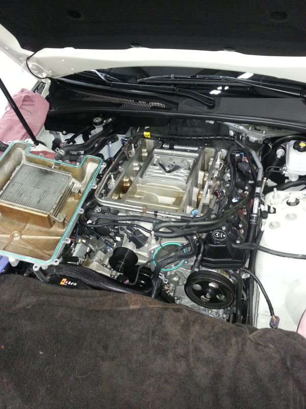

Tear down is underway!
Engine out!

Just a quick update on the progress of the build-
Everything is installed and we are currently in the process of street tuning this V, while breaking in the engine. Hopefully we will have some dyno numbers by the end of the week, along with some 1/8 mile passes if everything works out according to plan. :)
Here are a few pics I snapped during the process. I will have completed project pictures when everything is said and done ready for the customer to pick the car up.
Enjoy-
Zach
