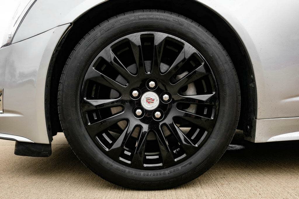

Here is a standard CTS brake caliper/rotor behind an 18" wheel. Much smaller.
