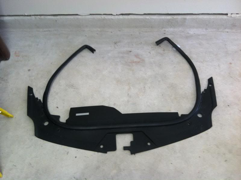

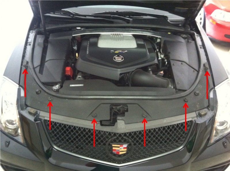

Remove upper cover

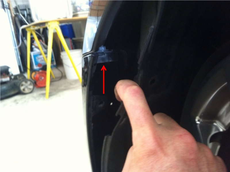

Turn wheels to right and remove 3 clips on left wheel well liner

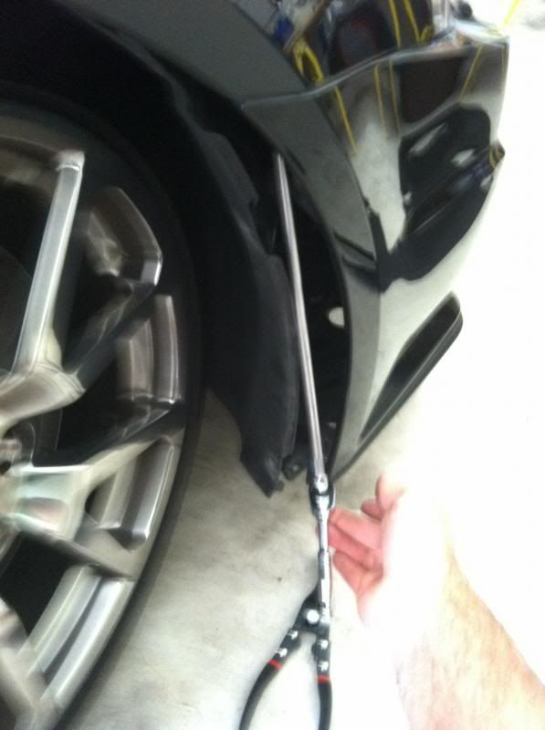

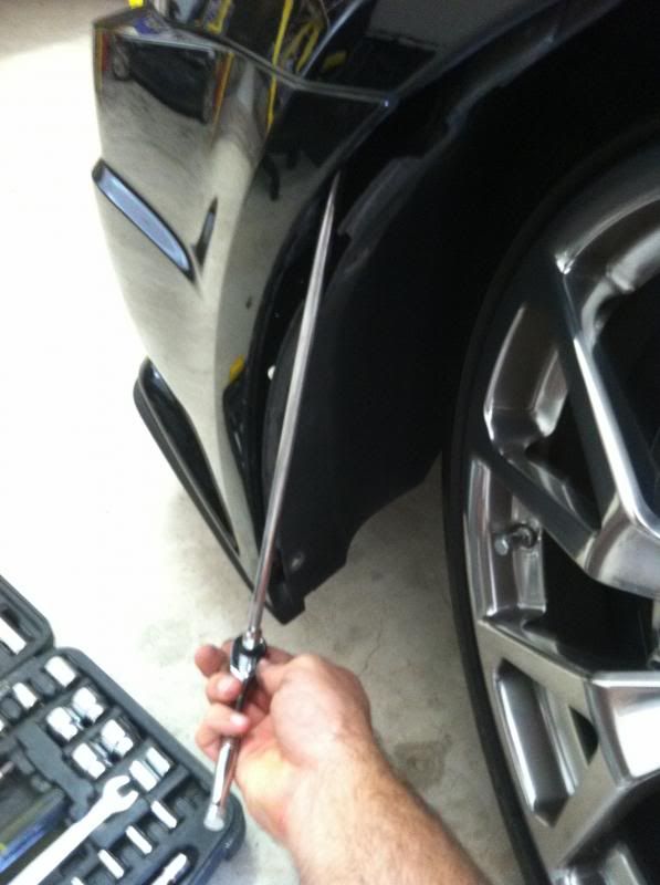

Pull front of fender out some to remove 10mm bolt
Long extension helps
Turn wheels to left and remove 3 clips and 10mm bolt

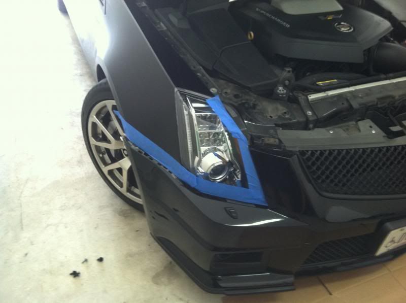

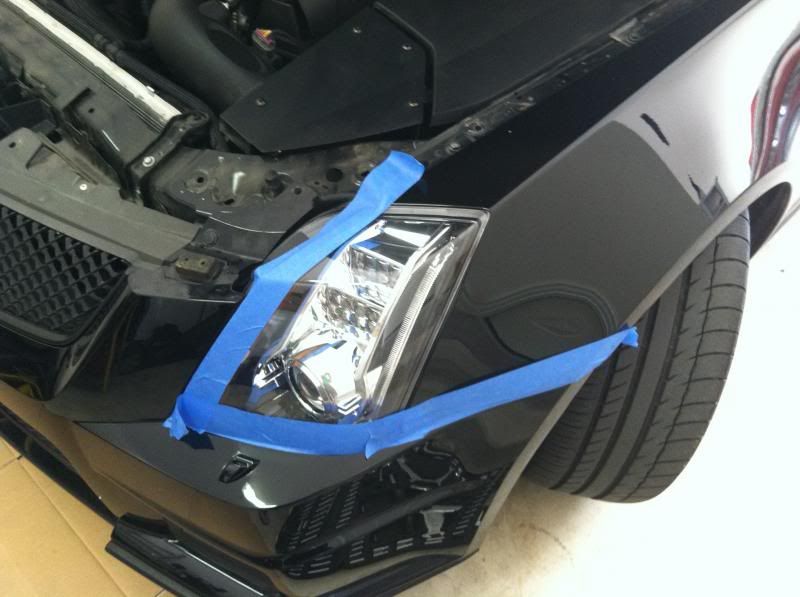

Protect the paint and headlights

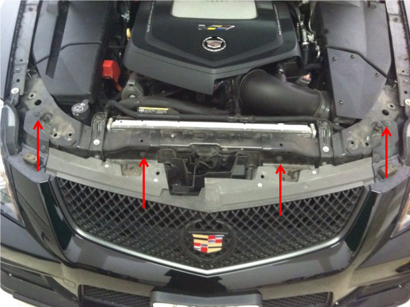

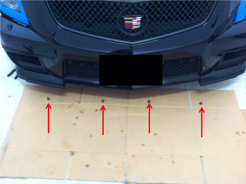

Remove 6 clips from under the bumper
Remove 2 10mm bolts in center and 2 clips at edge

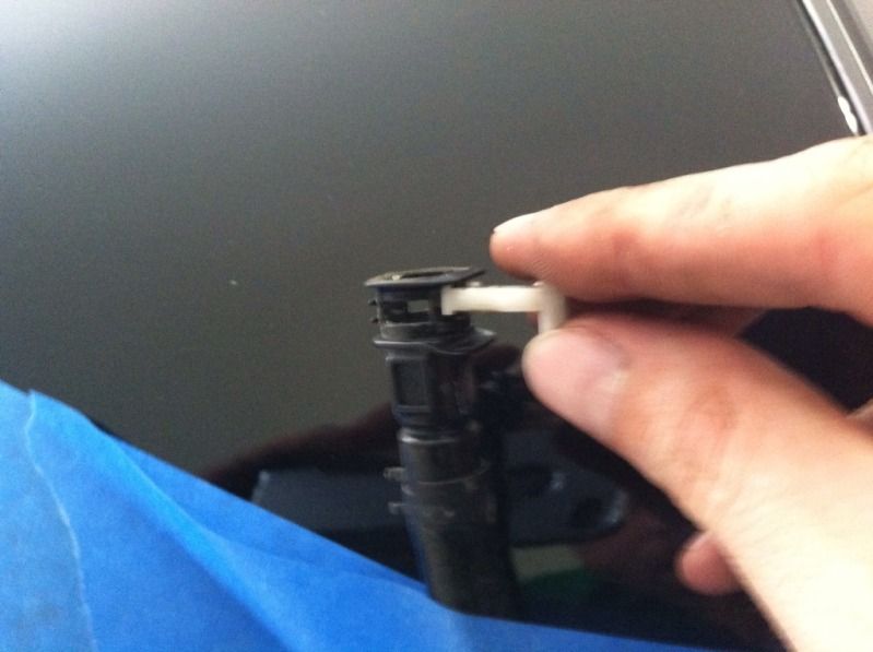

Pull front bumper foward to expose the headlight washer hose on left and right
Remove white clip so the hose can pull off

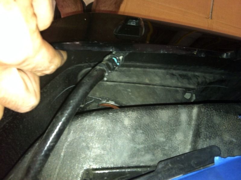

Tape the hoses up out of the way. They will leak if left on ground.

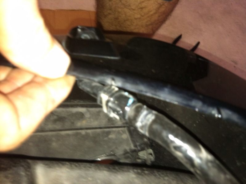

Remove the hose from the clips on bottom of bumper
