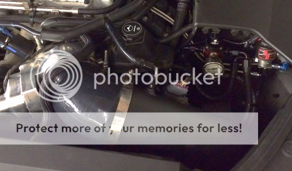

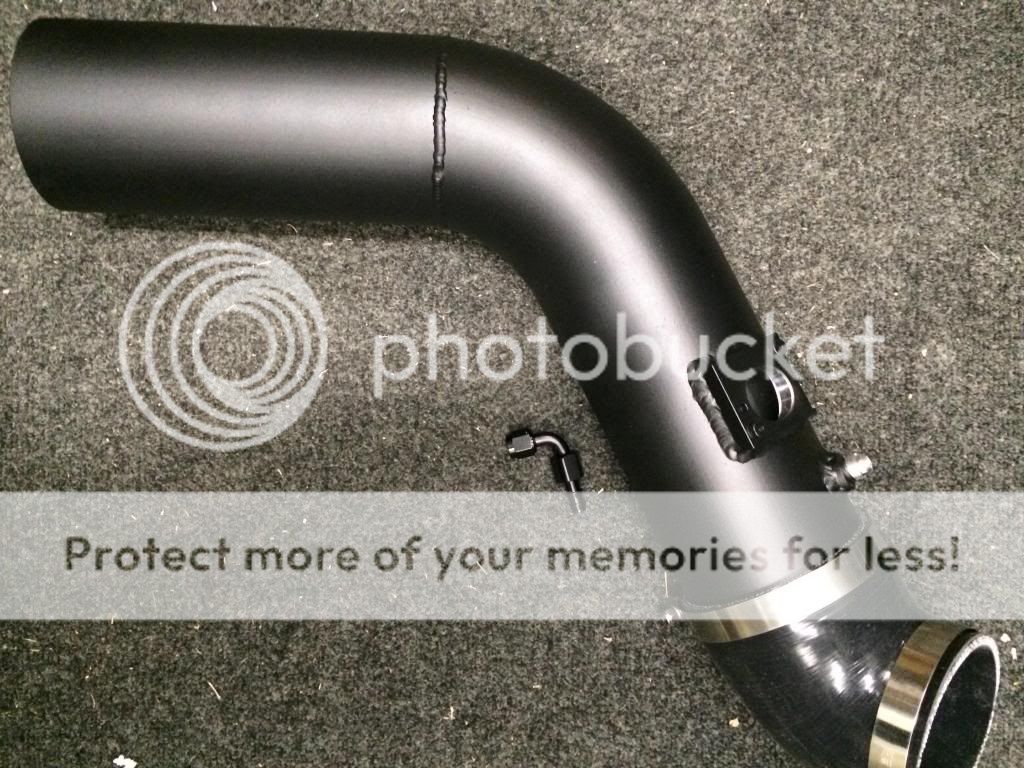

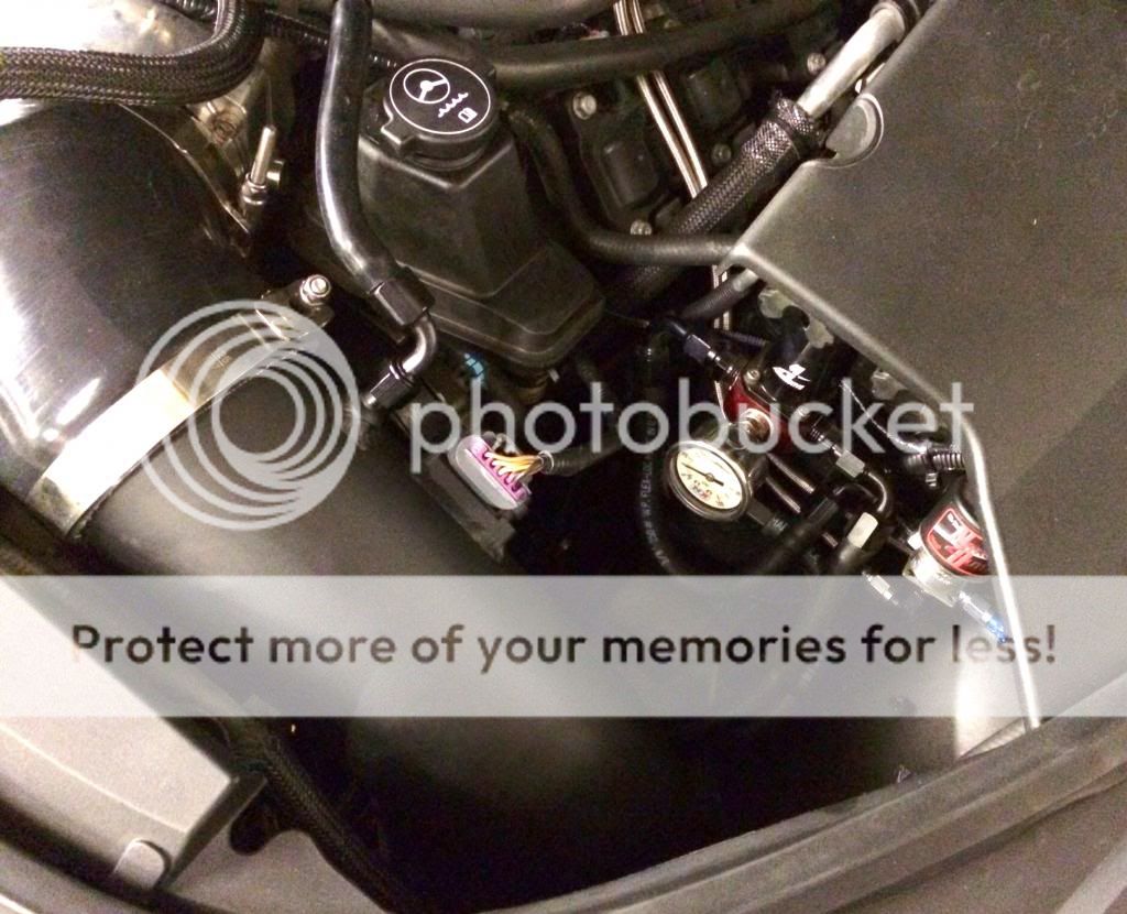

I know everyone will want to see pictures of the intake, so here you go.
In the buff:
On Josh's car while on the dyno:
It should fit with a modified stock air box. I plan to install it that way on my car and post pics.
1,129 Posts
drool
